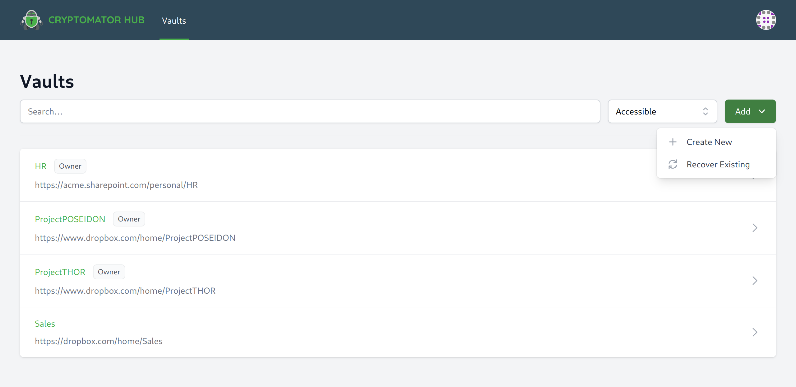

In Cryptomator Hub navigate to the vault list, click Add and Recover Existing
Vault list add drop down

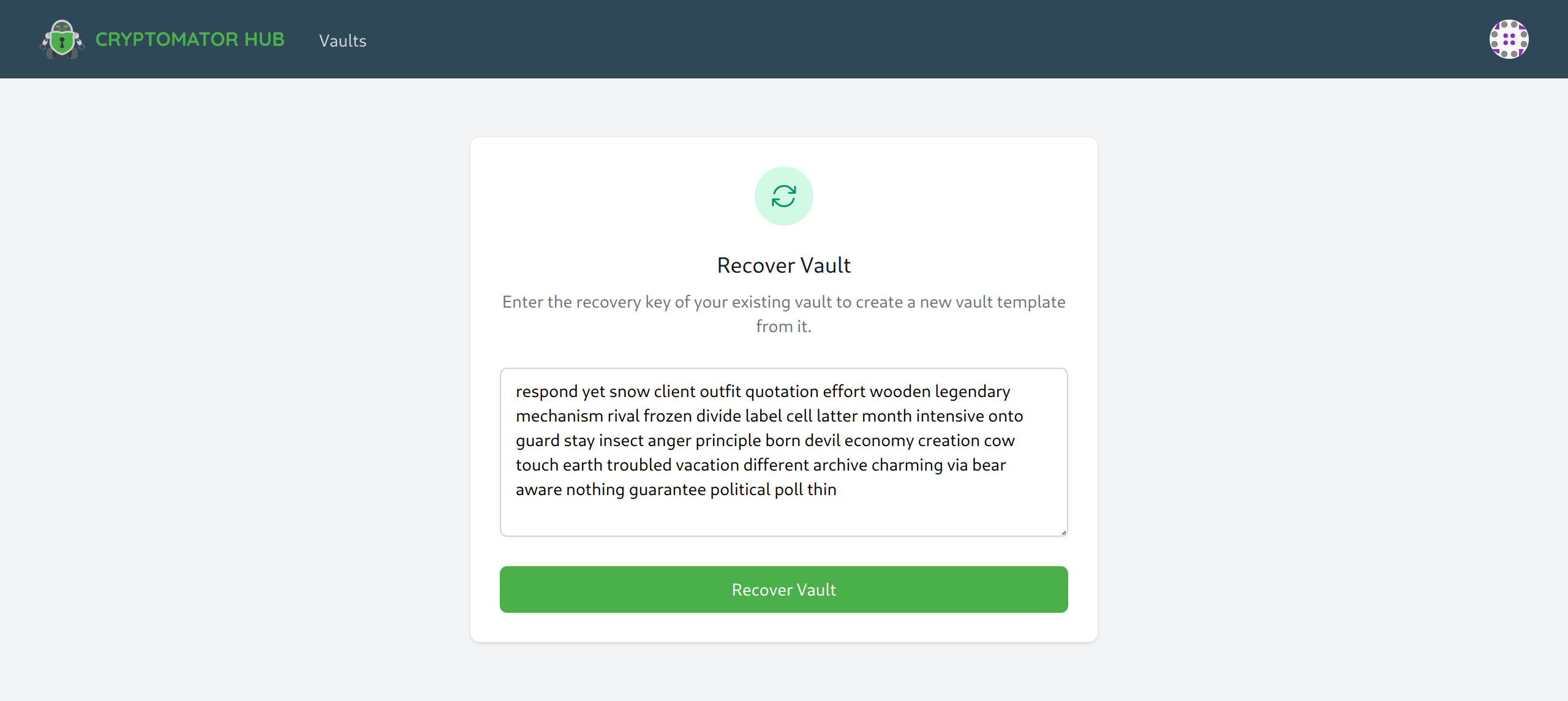

Enter the recovery key for the vault you want to restore. If you enter a recovery key from a different vault, the recovery will not work.
Proceed with Restore Vault.

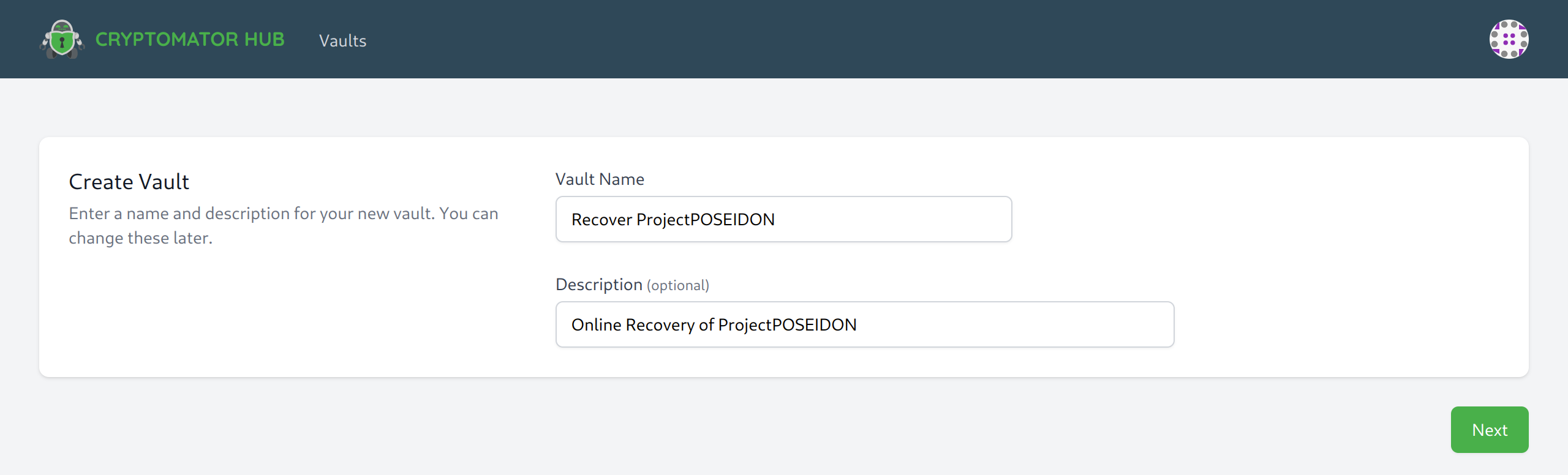

Enter a new vault name, description and vault admin password. The new vault admin password is required to grant or revoke access to the vault.
Creating a vault using recovery key

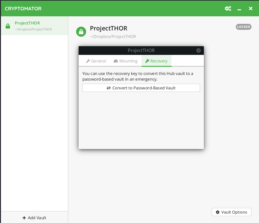

Open the Cryptomator desktop app, right-click on the vault you want to restore in the vault list, click Show vault options in the opened context menu. In the opening window, select the Recovery, read the label description and click the Convert to Password-Based Vault button.
Vault recovery convert to Password-Based-Vault

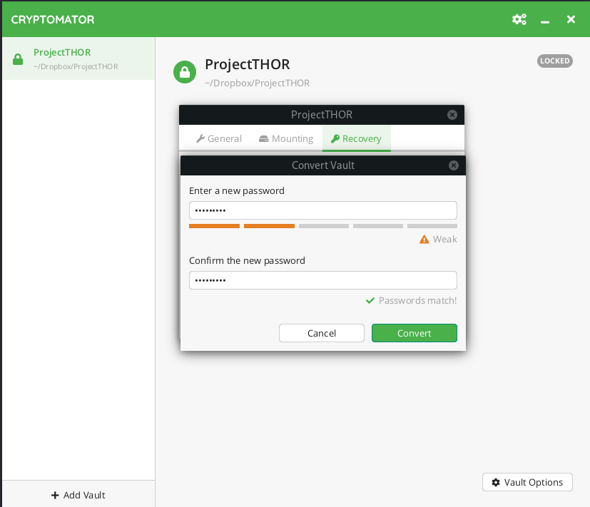

In the next step choose a good password used for unlocking the vault. Cryptomator requires at least 8 characters but we recommend you to use a longer phrases such as pass-sentences. The bar below the password field estimates the strength of your password.
Convert vault enter new password

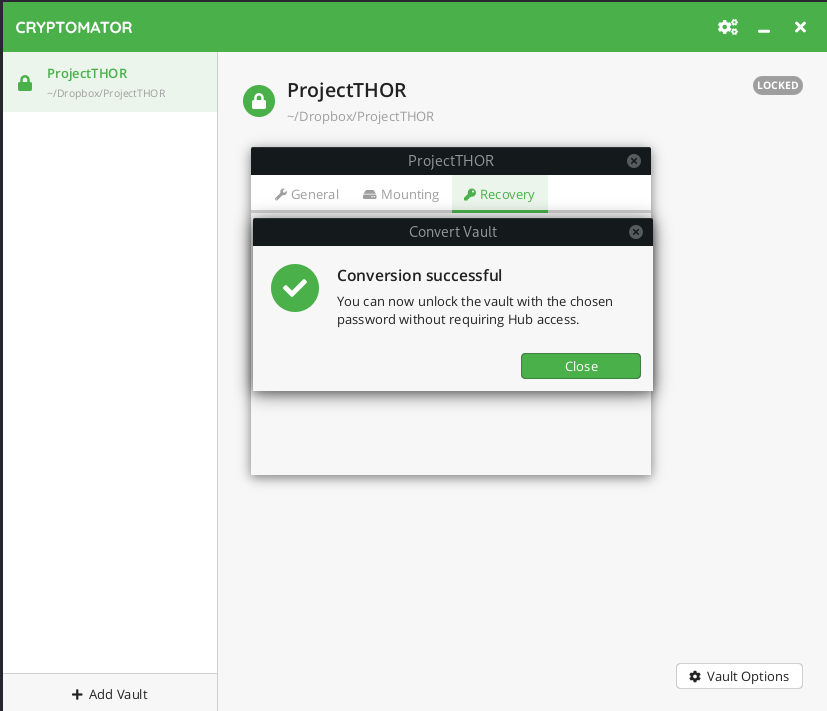

If the conversion was successful, a success message is shown. You can close the dialog box. This vault is now converted to a password-based vault.
Convert vault successful

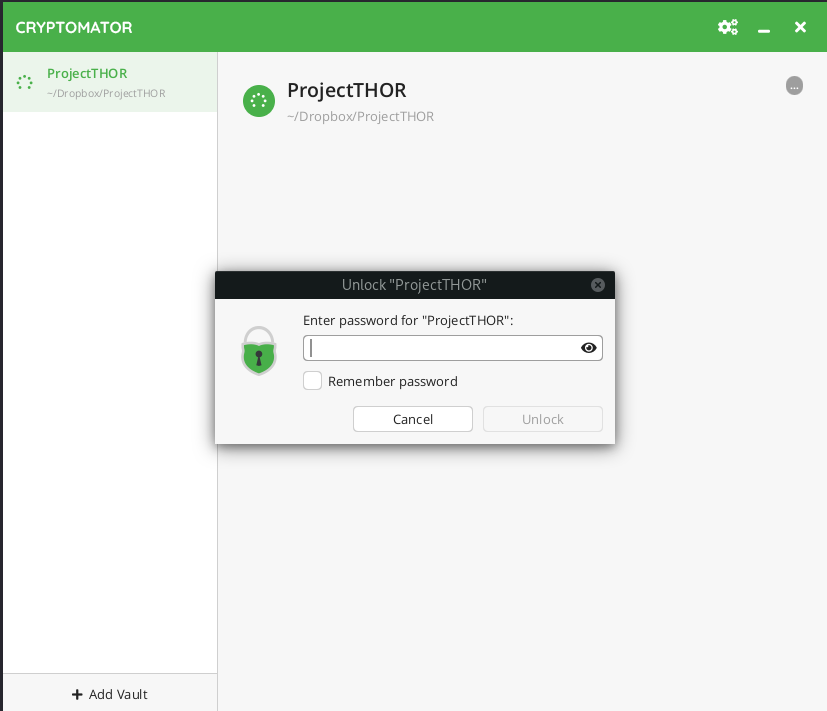

After the conversion, when unlocking the vault, you are prompted for a password and only the one chosen in the previous step leads to a successful unlock.
Unlock converted Vault
