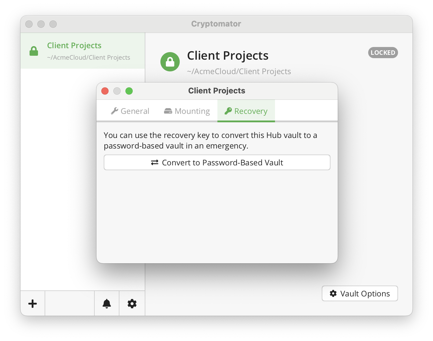

Open the Cryptomator desktop app, right-click on the vault you want to restore in the vault list, click Show vault options in the opened context menu. In the opening window, select the Recovery, read the label description and click the Convert to Password-Based Vault button.
Vault recovery convert to Password-Based-Vault

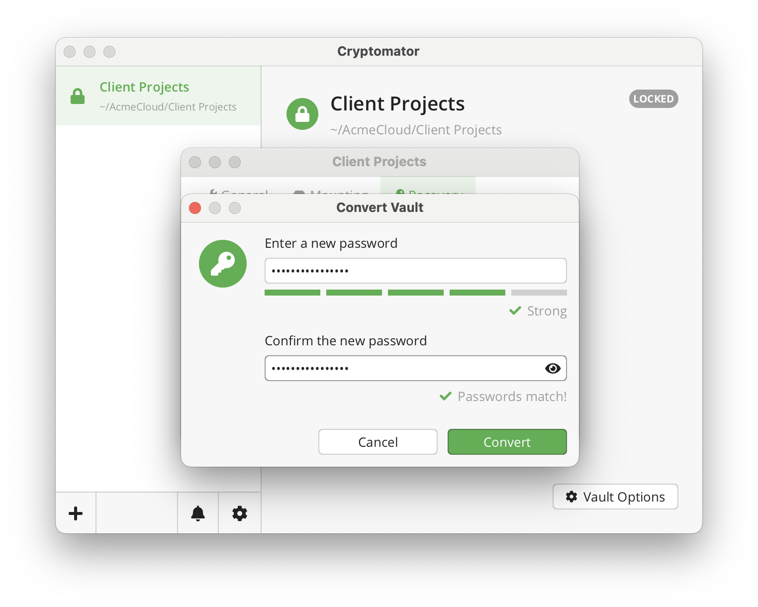

In the next step choose a good password used for unlocking the vault. Cryptomator requires at least 8 characters but we recommend you to use a longer phrases such as pass-sentences. The bar below the password field estimates the strength of your password.
Convert vault enter new password
If the conversion was successful, a success message is shown. You can close the dialog box. This vault is now converted to a password-based vault and can be unlocked with the above chosen password.
