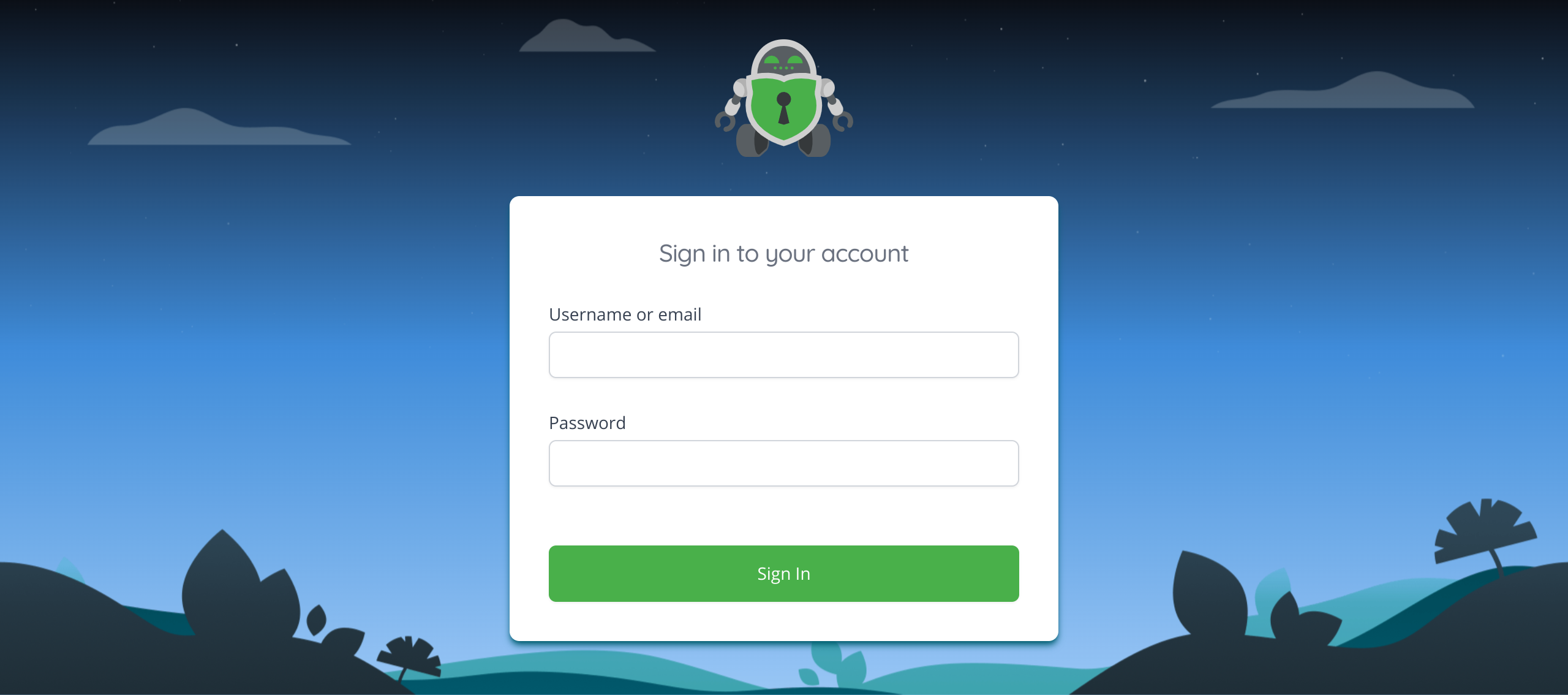

2. Authenticate
Cryptomator should open your default browser for authentication. If you're not already logged in, you need to provide your user credentials, e.g., by entering your username and password or by inserting your key when WebAuthn is enabled.
After your browser asks for credentials, enter your username and password

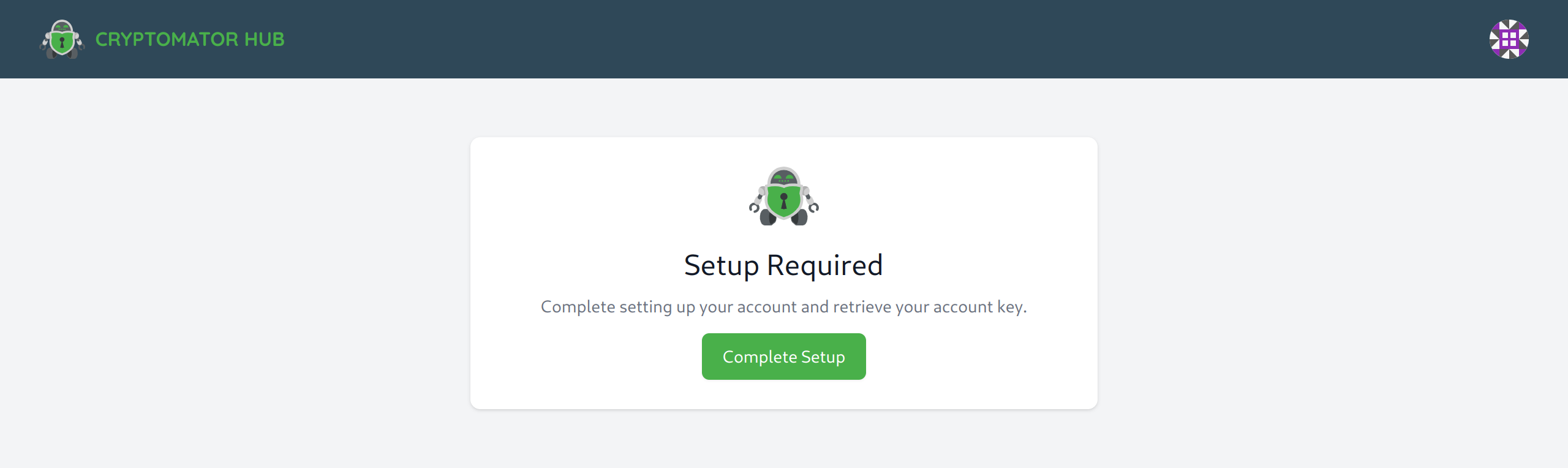

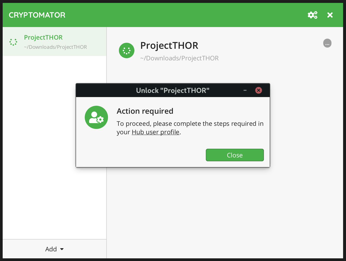

3. Register Device

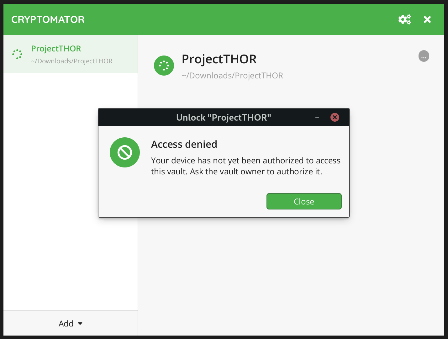

If you just setup your account, a vault owner needs to grant you access for the requested vault as described here. Retry unlocking the vault after the vault owner granted you access.
Access is denied since it has not been granted by a vault owner yet

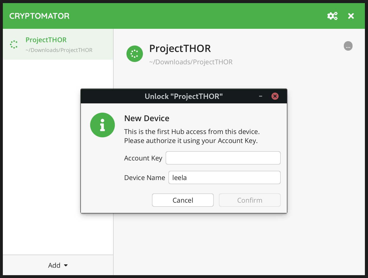

If you connect to Hub with this device for the first time, you need to register it.
Desktop
Register your device by entering the setup code and a name for it

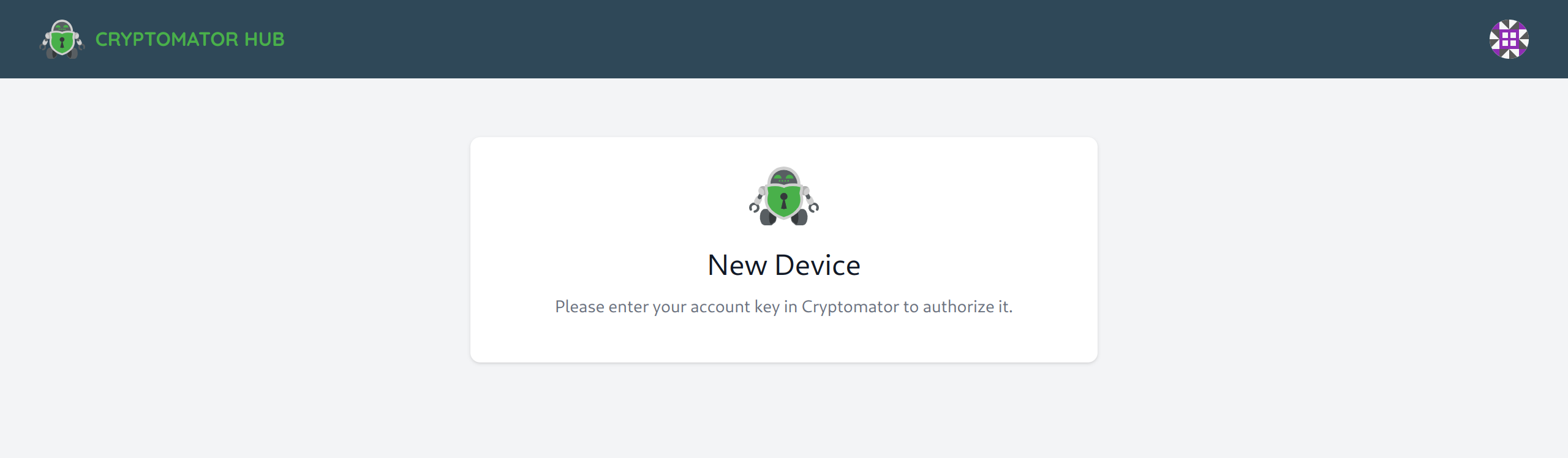

Hub
Hub requests device registration
Enter a name for the device to identify it later on and the Account Key which was generated during the account setup. You can also find it in the account settings.
After that, you will see a confirmation dialog, unlock the vault again.

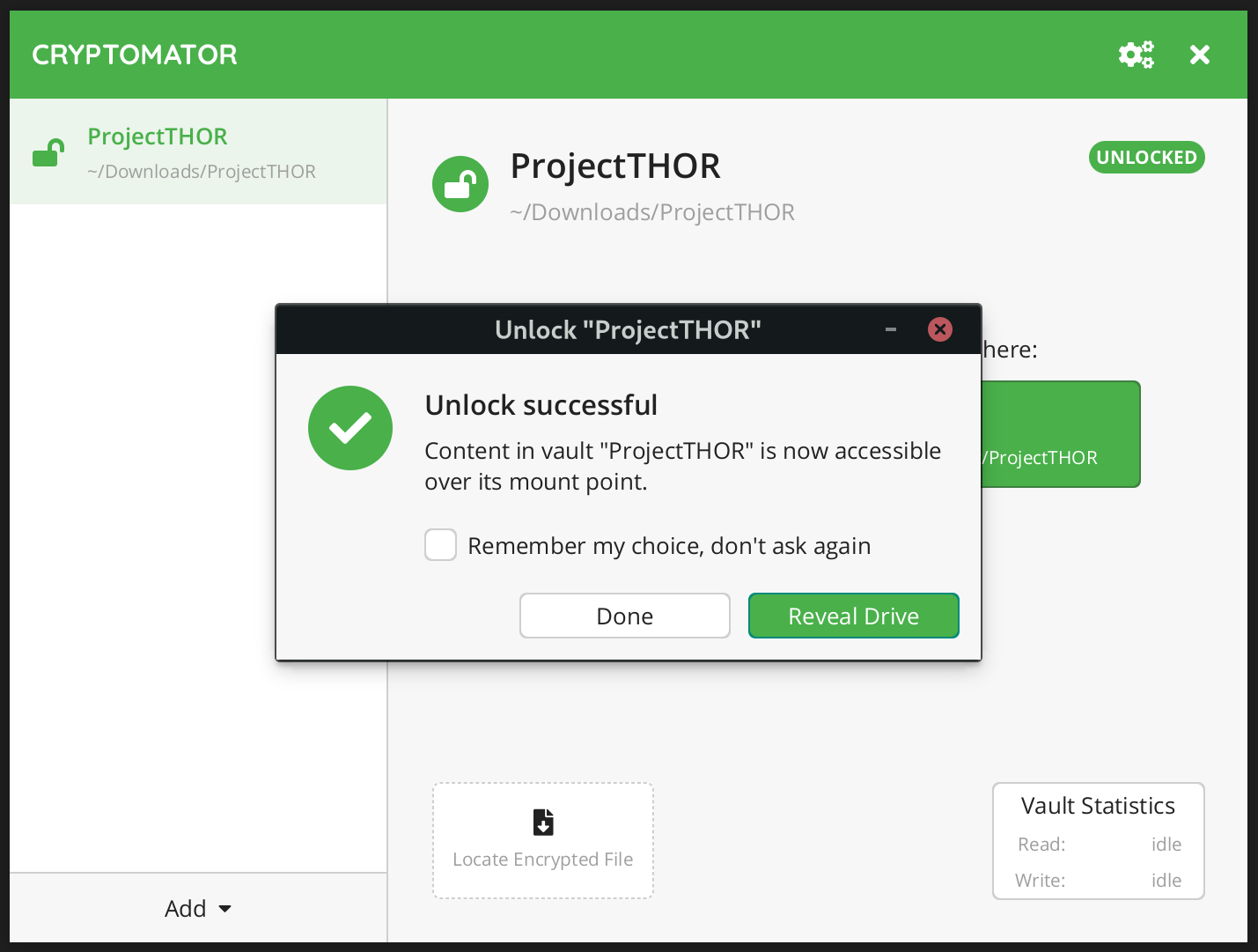

4. Vault Unlocked
You are all set up and an unlock should be successful from now on. You can then reveal the vault's contents as usual.
Desktop
Desktop shows unlock successful

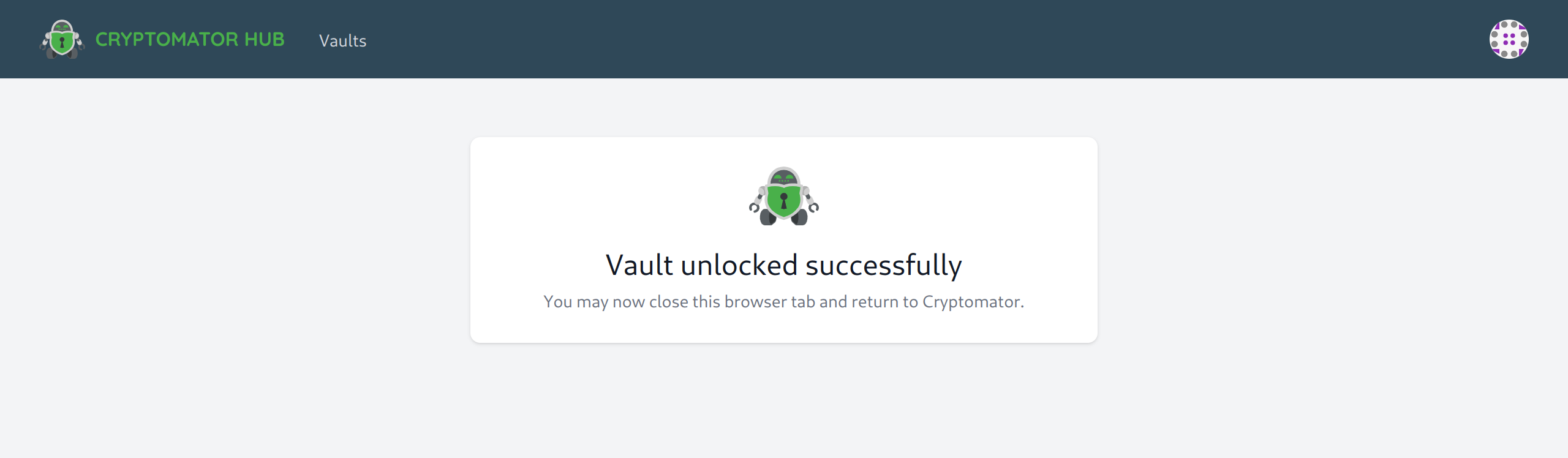

Hub
Hub shows unlock successful
